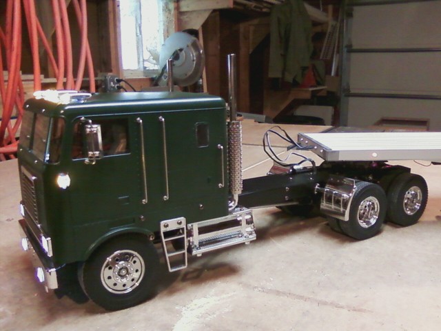

here's some work I did on the lighting. got the controller from a guy in Canada. quite a bit of work to set up for the truck but a nice product nontheless. I control the marker lights on the trailer w/ their own power triggered by an aux output on the controller to a solid state relay in the trailer. want to add more lighting to the cab and do some tweeking w/ the brightness but this is a start.
btw, those who have asked for lowboy pictures, there's not much to show. In fact I'm kind of leaning toward scrapping the aluminum structure and going to mild steel...thats down the line, need a couple of tools first

Bill, the lighting on the Globe looks great.
If I may ask, why are you thinking about scrapping the lowboy? It is a really good looking trailer. Adding some decking and swimg arms will complete it. I for one would like to see it finished.
