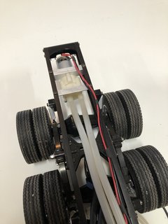

Homemade 4.25:1 GRU. The top speed is pretty good with the Tamiya trans locked in 2nd. I have another set of gears coming that will give me 2.5:1 and a smaller profile, so I'll see how that works with the trans in 1st.
Not exactly where I planned to mount the pump, but I couldn't get it to fit up in the pump panel area.

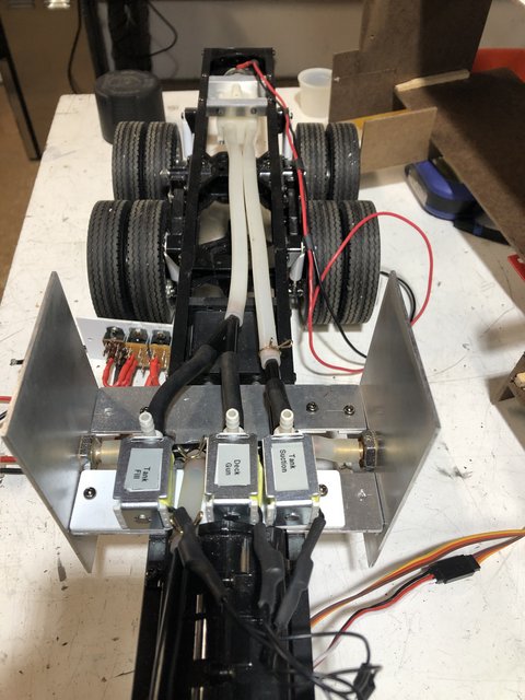

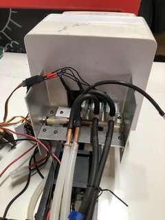

Started working on the plumbing and solenoid valves.

This is looking very nice! Looking forward to seeing this in action! Are those solenoid valves air tight as well as water tight? What did you use to make those suction fittings?

Thanks! The solenoid valves are for both air and fluids. The only thing I don't like is the ID on the valve is only about 3mm whereas the pump and all the intake plumbing is 5mm. So far, I haven't been able to find any 5mm valves.

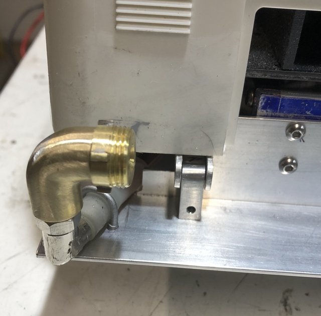

I finished the plumbing for the front bumper suction. With some milling, filing and sandpaper, I was able to make the 90deg elbow from a stock 1/8 FIP brass elbow and attach it to a swivel elbow so it spins.

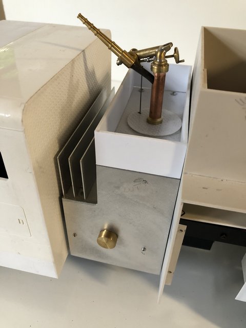

Here are some pics of the machined deck gun parts and assembly:

Those machined parts look great, but i really love how that fire monitor came out.
Have you given much thought to waterproof electronics, making water shields to help control what gets wet, and drip loops on all wiring?

Thanks guys! Yeah, shielding under the deck gun will be a challenge, especially with the linkage between the servo and the nozzle in the way. I have some ideas, but I won't know for sure until I start to build that area out a little more. I had to move one of the solenoid valves to make the stacked servos fit, so now I need to move the battery, master switches and receiver around...again.

For the linkage from the servo to the nozzle of the monitor you might be able to use one of the bellows that the RC sub guys use to get their control linkages to the rudder and dive planes out of their water tight electronics containers. I think the bellows are available in several sizes.

Thanks for the tip!! I was thinking of some thin rubber membrane with a hole/slit, but this sounds like a great idea! I'll definitely check it out.

I originally planned to mount all the relays and bus bars directly to the body, but that quickly became a pain every time I had to remove the body to figure out my next move. So I decided to take this mess:
and mount everything to a couple of free-standing shelves attached to the frame. This allows me to remove the body without touching most of the electronics.
