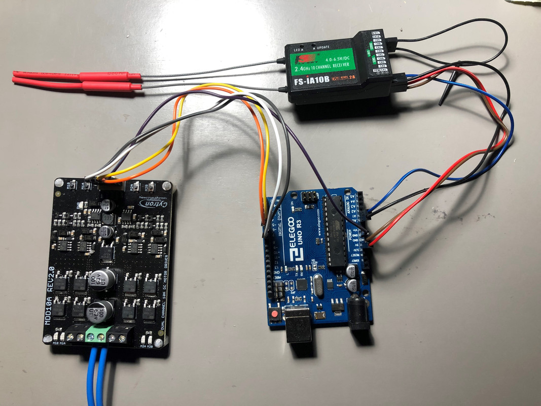

Which brings us back to electronics !
So i did have this running ( up off the tracks on a stand) using a 2x32a Sabertooth controller from my openTX transmitter ( Radiomaster 16 channel) and it ran as expected (very well). The only problem was when i was at full stick forward the RPM of the track was about 30RPM at the sprocket. Far to fast for what i wanted. With the sabertooth, you can just ease off the stick to slow down but that comes at the cost of torque as the controller just turns down the voltage, slowing the motors. A 24v motor running at 9 v just isnt as strong at one at full power.
Thought about gearing the motors down further ( way to much work and i really didn't want to go back to the drawing board on the transmission!) but i remembered another build thread that talked about PWM control of DC motors. Main benefit being that you just pulse the motors very fast for a percentage of time so that the motors slow but are still getting 24v ( but only for very rapid short bursts)
So after a few weeks i ditched the sabertooth in favour of the following PWM setup:
OpenTX radio talks to two channels on the receiver.
2 channels on the receiver are connected to inputs onto an Arduino microprocessor
Outputs from the Arduino are PWM signals for motor speed and another for motor direction which get connected to a PWM capable motor driver.
That's the easy part ! The hard part was writing the code for the Arduino.
After a couple weeks of Arduino code for dummies and watching every youtube tutorial possible i was able to write the code for differiantial/tank steering.
its a steep learning curve but well worth the effort. Its not just the benefits of PWM motor control but also being able to control lighting, sound or anything really you wanted. I will post the code below so that hopefully it may help someone else one day.
Setup:
Open TX TX16s transmitter (2 channels for drive motors)
10ch receiver
Arduino Uno (Elegoo starter kit)
Cytron MDD10A Dual Motor Driver (PWM input)
2x24v brushed DC motors with 1:72 planetary gearboxes
7s LiPo at 24 v

I raised the frequency of the PWM to remove the high pitch whine and increase driver efficiency but not necessary. I have this working on my desktop (image) and its working as i would want. once its installed i may have to tweak the steering inputs but generally its a good starting point.
Thats enough for one day !
feel free to ask questions if needed
Rob

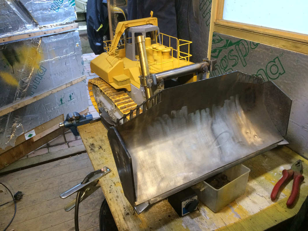

Old 05-03-2021, 08:09 AM
Default Re: Newbie Scratch Build - D575A Dozer
Originally Posted by sparkycuda View Post
Don't think you miscalculated on the weight/balance concern. The real dozer has a massive counterweight when not equipped with a ripper. The 1:1 machine is very nose-heavy without either. So, maybe just about right!
HI Ken
i think your right, i added some crude weight to the back and its rolling a lot better on the tracks now. Plus i added some stiffer rate springs to the tensioner and that seems to help as well. I have started the ripper now so should have it attached in a couple of weeks.
in the mean time i added some details to the blade:
must be like strengthening bars on the side of the blade
My own version:
I will take some pics to give a sense of size later today maybe with a can of coke or something but blade is about 500 mm wide ( 21 inch) x 250 high (10inch)
Rob
