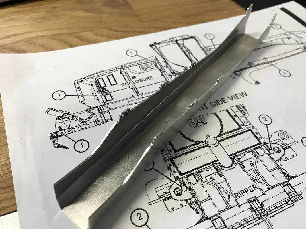

Making hatches.

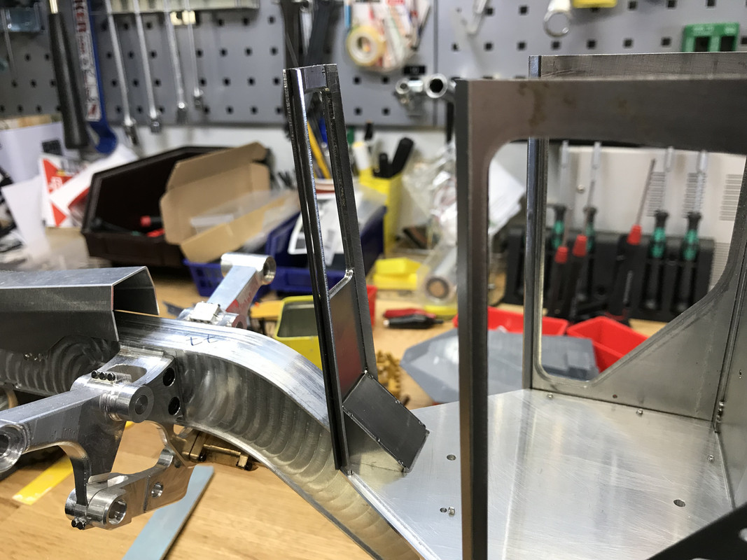

This is the cab back wall.

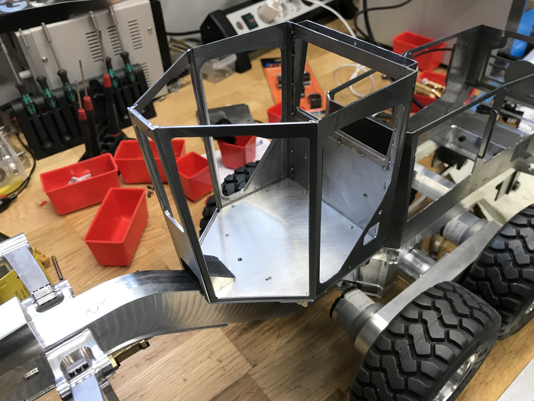

I got the other side cab panel done too, also in the picture there's a 3D printed roof that my buddy printed for me(still don't have my own)
