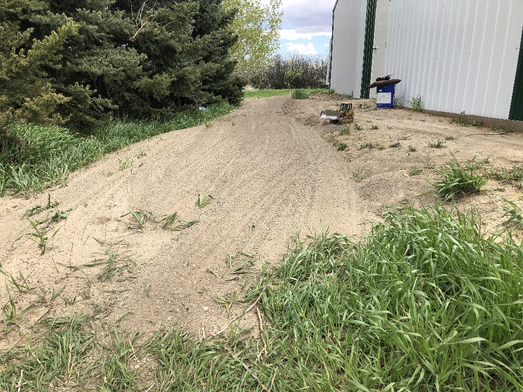

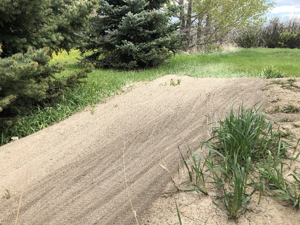

It really does work slick Emil, carries a lot of dirt, then roll the blade back a wee bit to empty & pack at the same time.
Start of the 3rd cut today
1,5 hr later
It’ll take about half hour to shape both ends with the ScaleArt loader with u-blade for trk entry. And another hour outside with the dozer leveling what I spread.

Before
After... you can see how hilly it is throughout its length; I need to get started on my next project, a pull grader with powered axles connected to the 4206 to get the peaks & valleys leveled out, as well as a slope of 1” drop per foot to the trees...

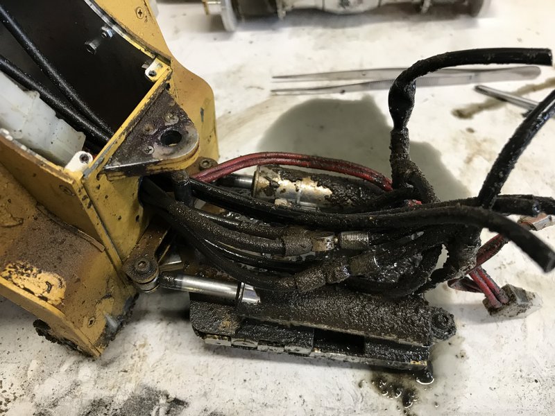

Then yesterday blow a hose on a steering cyl of the ol Stahl loader, under the cab... major disassembly to get to it... 15yrs of oily grime, yummy
After everything cleaned with electrical cleaner & pressurized air, start reassembling with new stiffer higher pressure hose... and some blood loss a long the way.

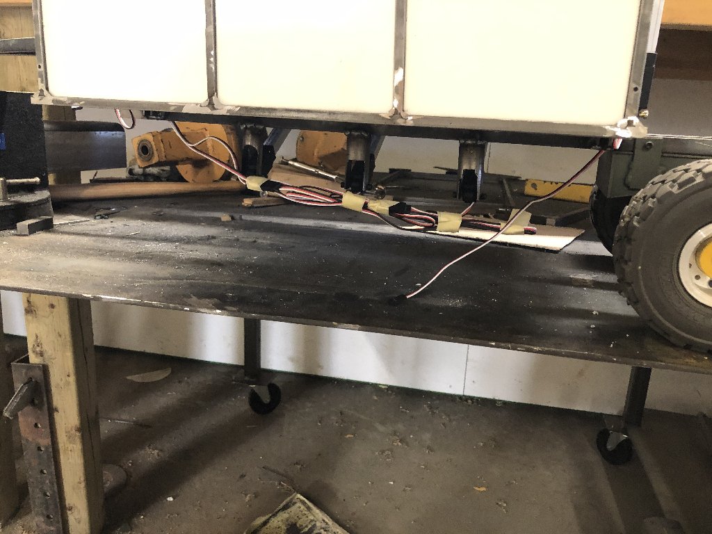

Funny thing happened, when I turned the model on & got the hyds primed; I test the forward/reverse & the front & rear axles turned opposite each other I put the rear axle in backwards 50/50/90 rule, story of my life. Luckily with just the removal of the cab & hyd pump, I was able to reach the Wedico plug that connected the axles together, popped the pins out on the male end & reversed their positions. PHEW!

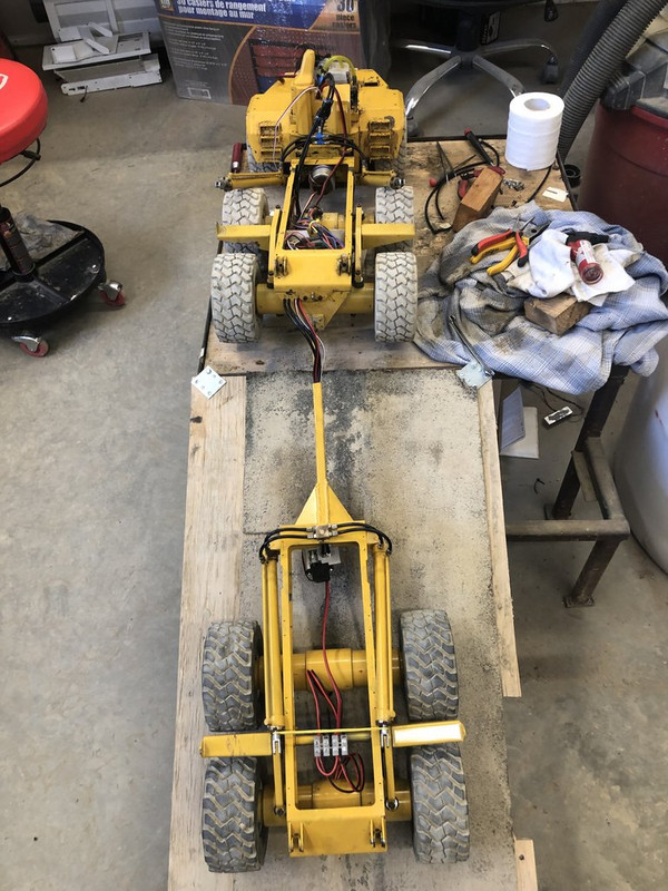

#1 B50, it was this month in 2015 when it started hauling, I think it might of been Apr 15; I had to change bushings in the suspension beam, the axles were moving side to side way too much.
#1 has brushless drive motors, way more power to pull a pup up my 20* ramp out of the basement, the pup has brushed drive motors, the ADT itself doesn't have enough traction by itself to pull the pup up such a steep grade. Tried it out tonight, works pretty good, much better than the other ADT with brushed motors. I now have these 2 ADTs paired on a DX9, not quite enough channels so the pup dump & #2 ADT steering are on the same channel.

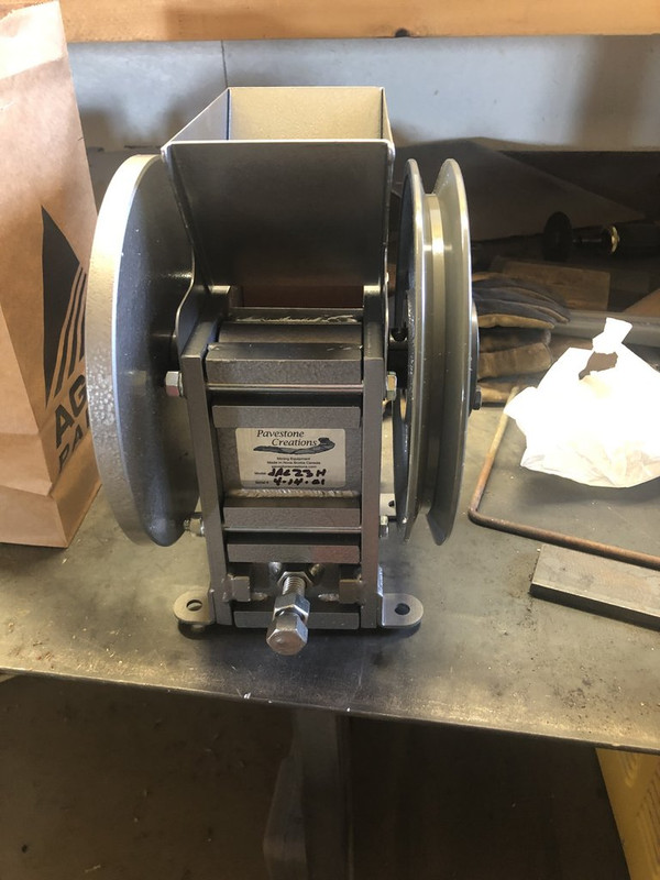

My new crusher from 911 Metal Lurgist showed up today.
It's a lil taller than the old Geneq crusher & an inch wider so it crush more material faster, hopefully nonstop with the loader feeding the screener.
Mounted up to the old the old Geneq frame today, just need to get a new longer v belt for it tomorrow & give a go. On 911 metal lurgist site, it recommends 1hp, but I'm gonna try with this 1/4hp motor 1st. The material I'm putting thru it has already been crushed once by the larger crusher & sized down to about 3/8.
