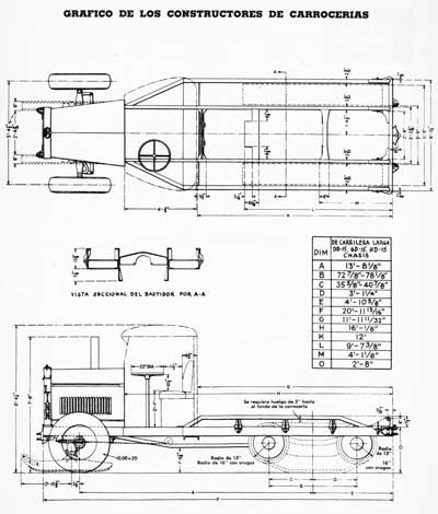

Originally Posted by crueby View Post
Looking great! Did you find plans/drawings somewhere, or are you going from old pictures? Not sure if there are any of these still in existance? There are a few of the Lombard versions around. Will be following this build!
Thank you. I have not been able to find drawings from the manual, but I was able to find this export specs sheet from this page http://www.coachbuilt.com/bui/l/linn_mfg/linn_mfg2.htm it got me good reference dimensions and from there I'm scaling pictures and videos that I have found on the net and working off them to design the individual parts in CAD for 3d printing or fabrication.
