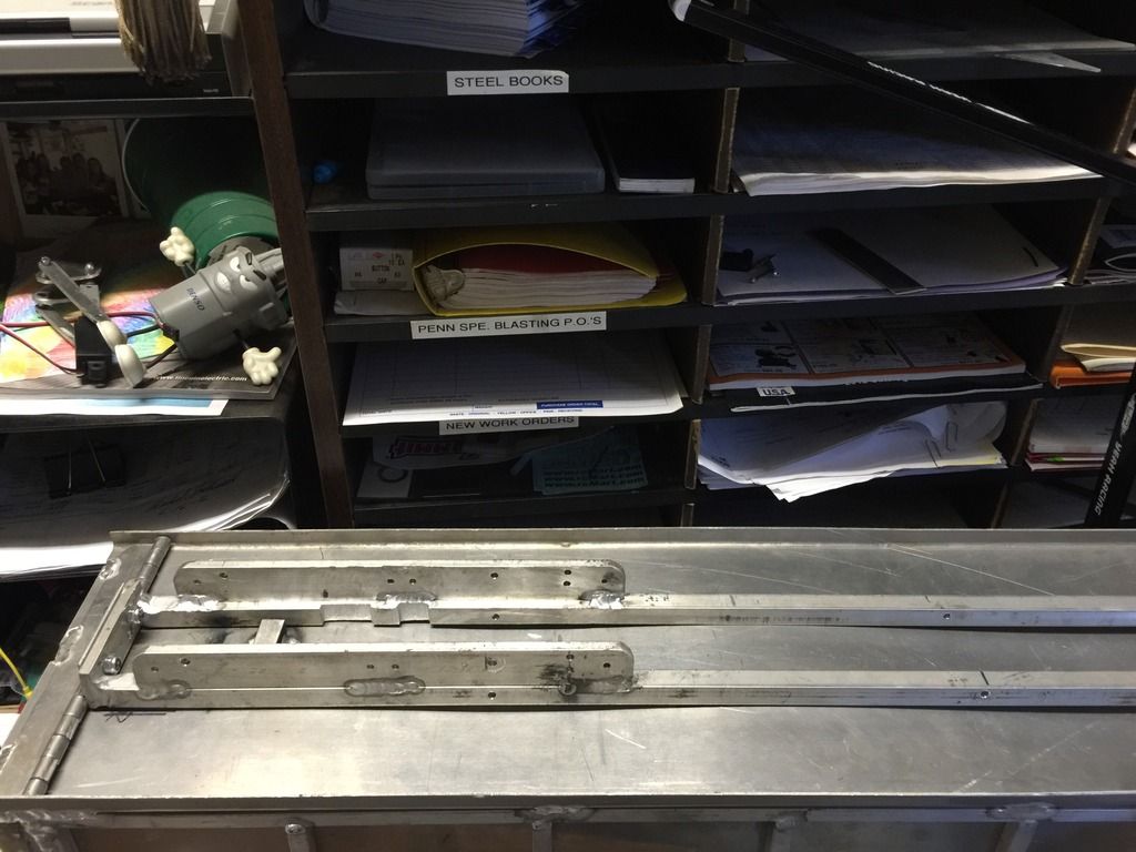

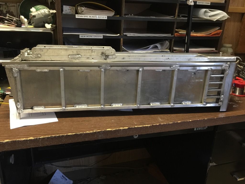

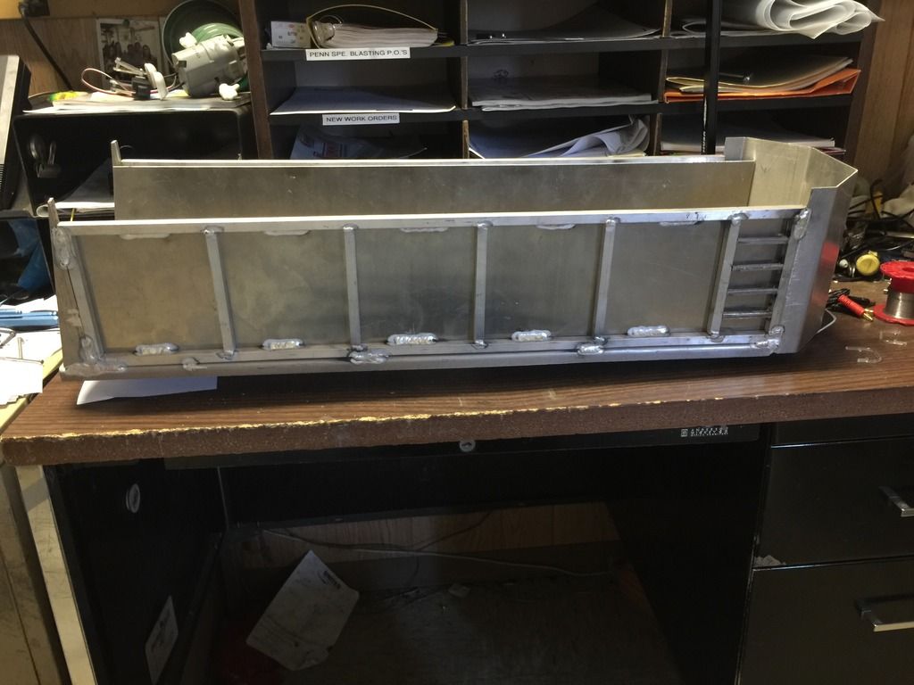

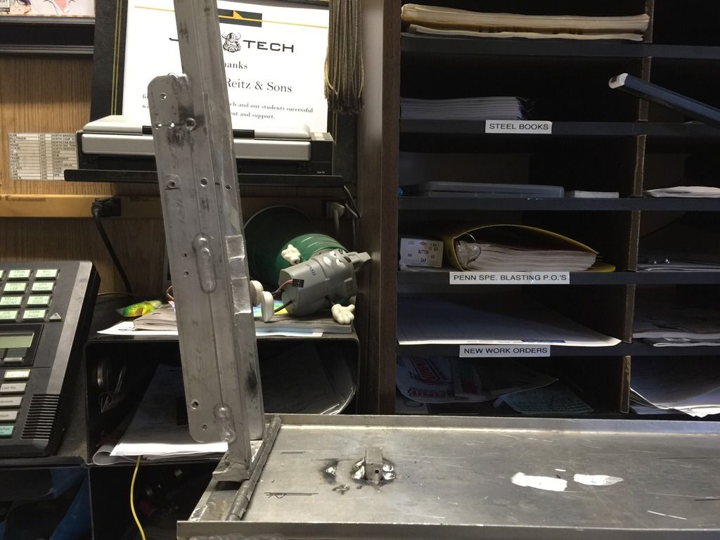

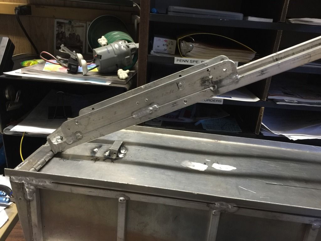

i think i need more help with like linkage and stuff to actually get my dump to function correctly

TRUCKMAKER 08-29-2016 11:15 AM

Cool! Are you mig welding or brazing? That is 1/4" square stock right? I don't even have the gas setup for my welder but I would really like to try my hand at welding some AL. That trailer looks serious, I like it! :cool:
Jim
Sped74 08-29-2016 11:59 AM
Re: need help with dump trailer
having a guy at work TIG it. i'm the fabrication manager at a fab shop lol
