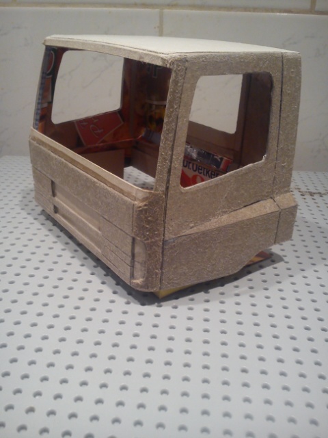

I Like to use unusual materials. In case of this truck garbage as row material. But the pizzaboxes aren't the best quality of cartboard. And thats why they absorbe a lot of polyuritan lacker. When the lacker is set the cardboard is stronger than a cab build from plastic sheets.
Here the lacker is aplied to most of the cab. One coat is enough. A second wound be absorbed.
Here I started to aply the putty to smouth it out.
