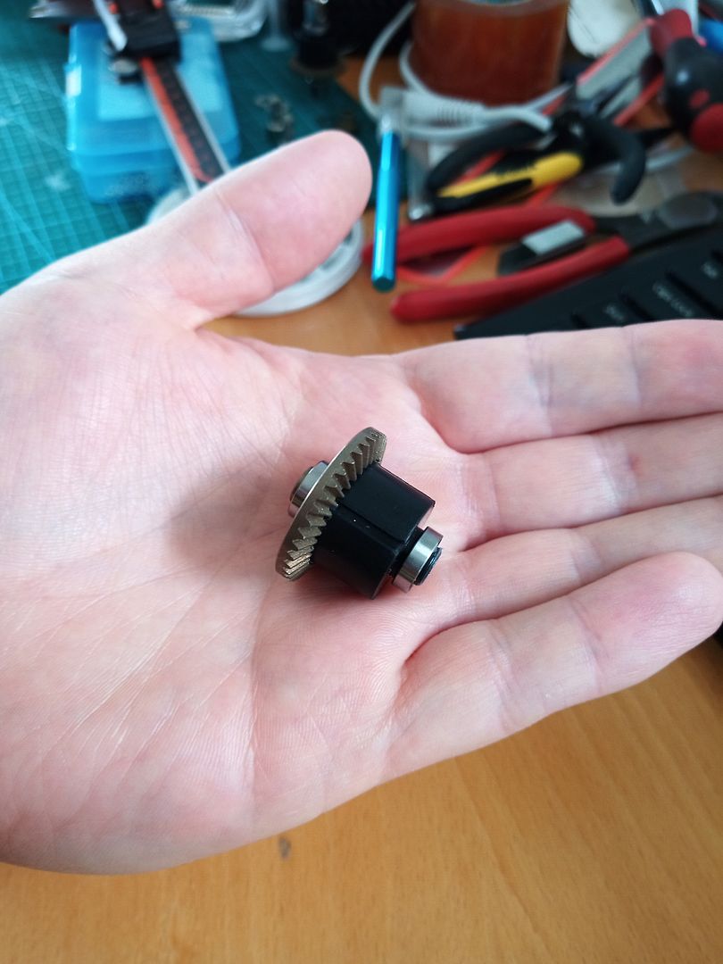

Kinda forgot to mention, before I started drawing I ordered WPL diff from Banggood and designed the case around that, looked small enough so the axle wouldn't be too bulky.
I wanted to have most of the "normal" components commercially available, I might be able to draw a diff but I doubt I could make one...
Had before a set of smaller bolts, smallest I think are 1.2mm.
Also had some bearings from previous builds but needed smaller, was surprise to find 2x5x2mm bearings, friggin tiny.
