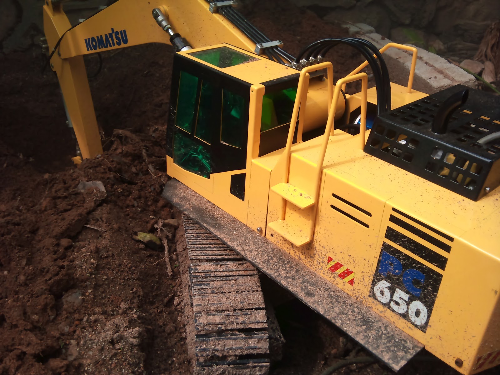

hi, i wanna share some final look of my build....when all the decal n sticker meet the cabin body....next is time to improve my handling skills...still far to match Reg in his Volvo EC300D..will share some video later..

That is nice build! Congratulations on your accomplishment!
One thing that bothers me is that the hydraulic rams are silver but yellow or black would be bettter for these.
Have fun with this and show videos!
yes, you're right, i'd missed this, suppose to be yellow in color, will do the touch up later...thx for pointing this out..

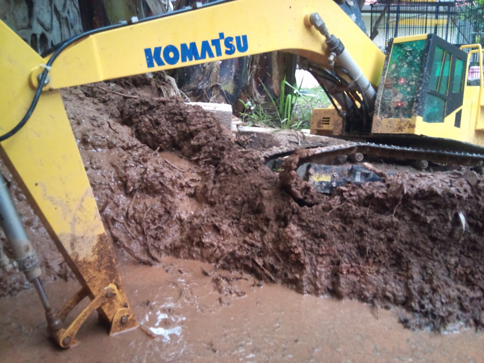

It is rainy season nowadays, and i wanna test my EXCAV in the mud. So, I dug a hole and waited for storm water to fill up and plan the mud like a kid...see video below:
See more details in my blog: http://my-rc-page.blogspot.com/
