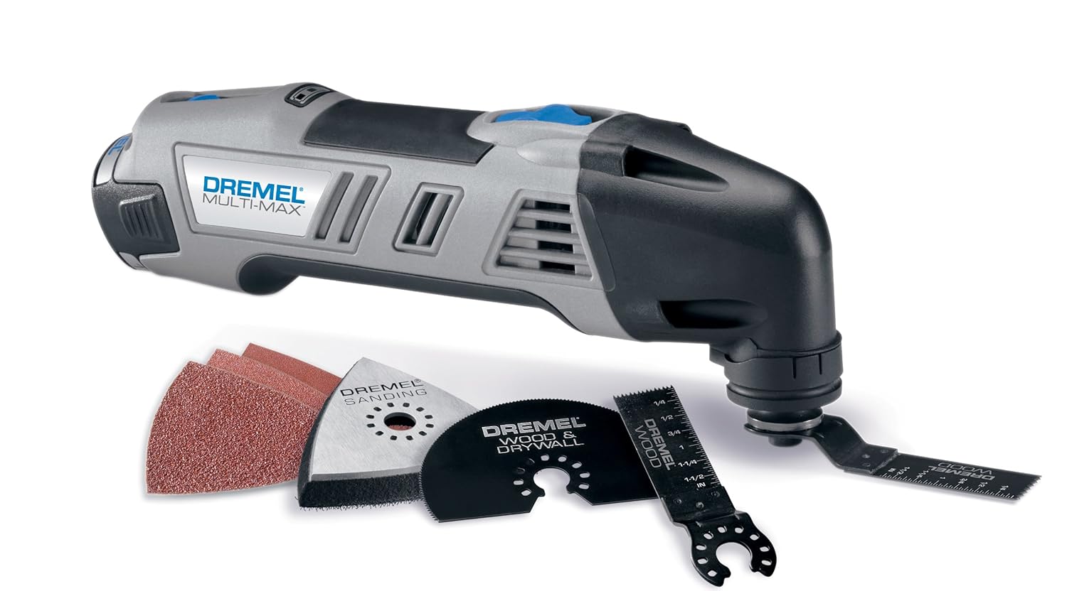

Not familiar with that body but ive had good success with one of these using the cutting blades on bodies.
I use brake fluid to remove any paint from plastics. Let it soak in a pan and keep brushing it on. You should have the paint loosened up and dissolved in a matter of 30 minutes depending on the thickness. Hope this helps.
