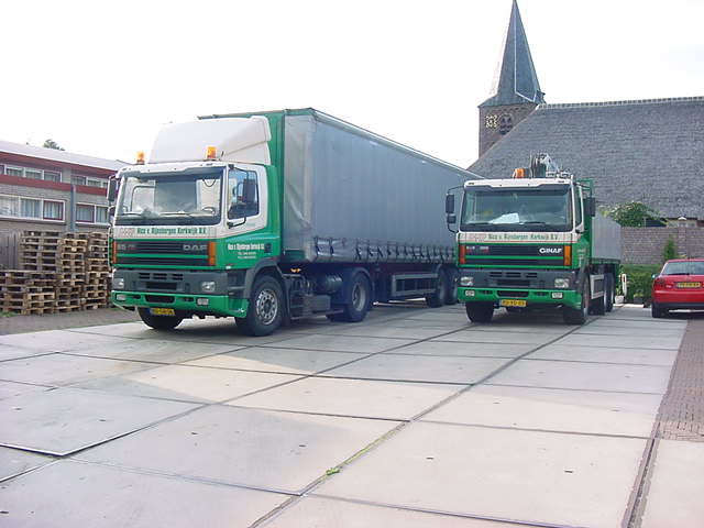

Hi.
The left one is going to be build

Hi. Well the thing about DAF my grandfather was one of the first to own a DAF truck. In my great grandfathers company. And the brand stayed the main supllier of the company. Thu the years and generations. That company splinterd into lots of small busnesses. Both trucks in the first picture were also the last I drove. I have an office job now. That gives me the spare time to build model trucks.
