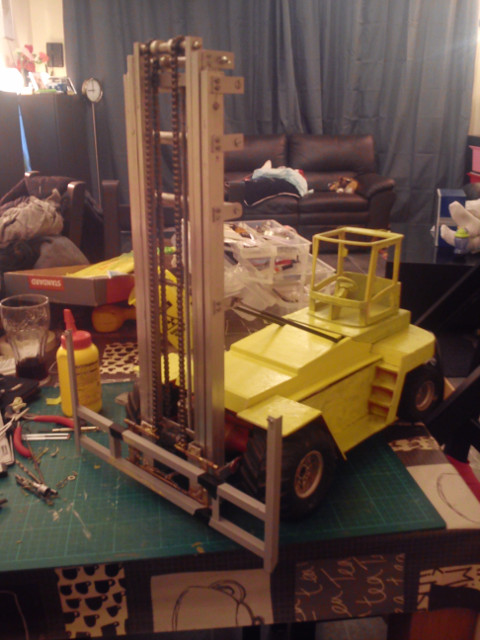

after some plywood work of my own it started to look likt this
and with the mast on.
the mast is now the focus of attention. it doen't slide like it's suppossed to.
it reaches the nessesery height. the bottom of the container is over 1.2meter. and it can lift 2 containers at one time
and a small problem with te tyre's they are hollow. and with a container lifted they deflate so the base of the mast hits the ground and driving is not possible.
maybe blocking the deflate hole is enough.

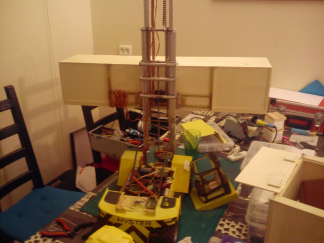

getting some RC-equipment ready. with stuff I had laying around I dug up this little puppy.
I wasn't working when I placeed it aside, the difference between theory and practice made the wheels inside the mast hookup with the boldheads also inside the mast.
after fixing that.

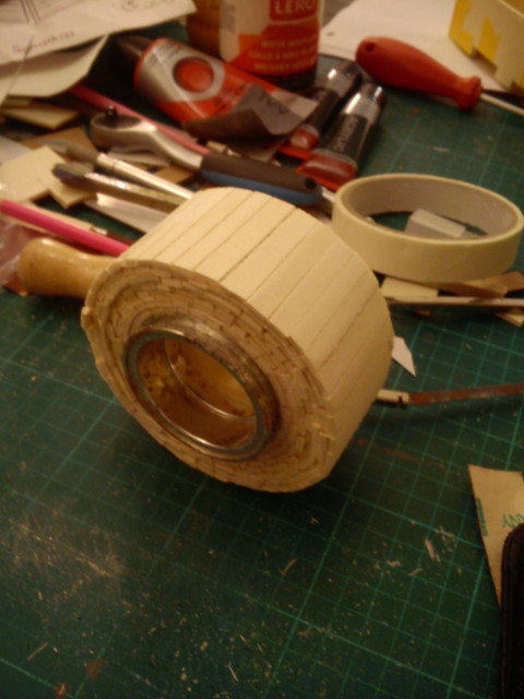

the wheels where up for adjusting. the front of the stacker was to heavy for the standard tamiya "mad bull" tyre. so I got the tyre off the rim. and had put some foam inserts in. that worked one day. after one night standing on the workbench. it got some flatspots. so that wasn't working. and after a flat tyre om my car. and having a look in the runflat tyre. I have made my own inserts. a bit like the foam inserts, and a bit like the runflat rims.
I just filled it up with woodstrips. but not to the full. so the tyre flexes just a little. and not looks like a solid one.
the paintjob still needs some attention.
but the mast runs fine. The attachment of the chains hooked on this film. and it's fixed now. and added some grease

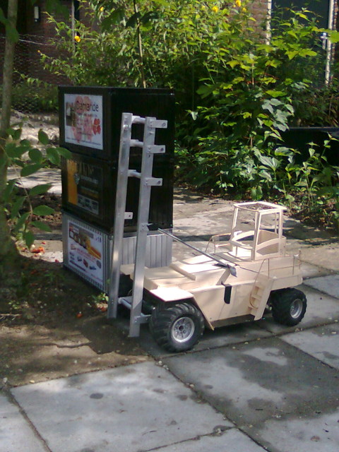

I also have made some other containers. here is a test to hookup a 40FT one.

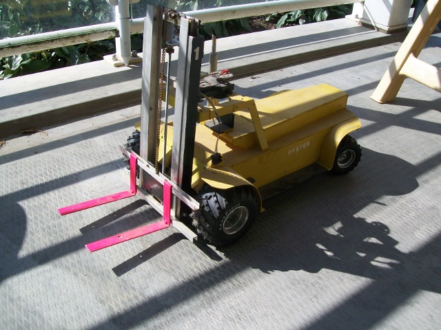

the model I bought
body almoust ready.
body ready. mast working
the wooden innertyre
with a 40ft container ( also homemade )
