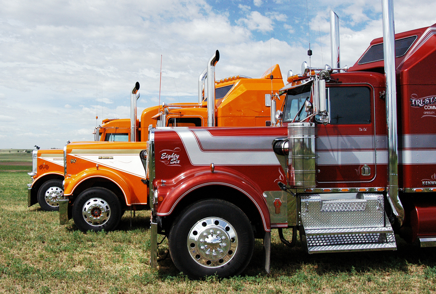

Honestly I think the gap is a little high but I would not worry about it. When you paint the truck, add the lights, air horns, stacks and mirrors it will all help hide that gap. If you do some shaving, keep the rivet line on the sleeper and work on the roof section.
here are a few 1:1 examples, it's hard to find a good top view.

Thanks for the pic's Claus. I might leave it, not sure yet. What to do, what to do...
