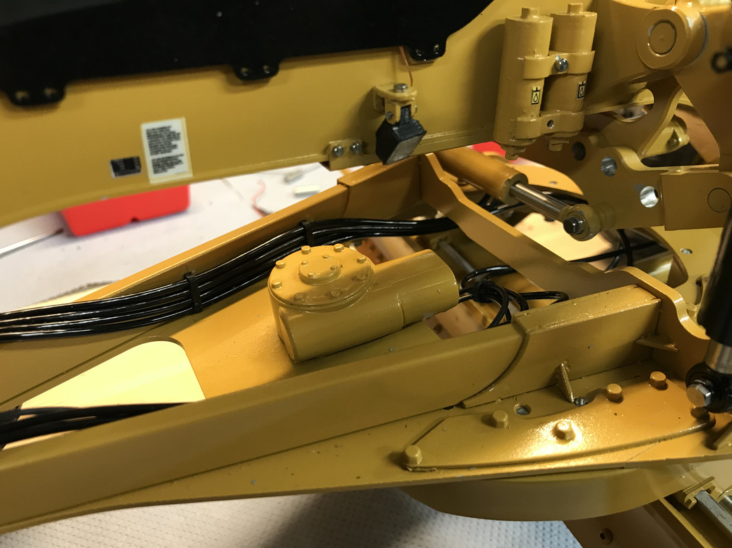

I got the rest of the hydraulic lines connected to the cylinders

oh my god that is a lot of hydro hoses gonna love to see it all plumbed and place send lots of pictures huge amount of work good one you are a master have you thought of doing 1/8 scale at all

How many meters of hyd hose you up to now!
What size hyd hose?
  #217
Old 02-01-2020, 12:54 AM
Default Re: CAT 14M3 Motor Grader
What size hyd hose?
I think I'm close to 13 meters.
It's 2x1mm hose, I can't fit any larger size, luckily the cylinders only have 8mm and 10mm bores.

I get terrified when I have to work on the hydraulic hoses for the wheeled loader. The amount of hydraulic hose that you have to run for that grader is mind blowing! Great build, I LOVE it!
