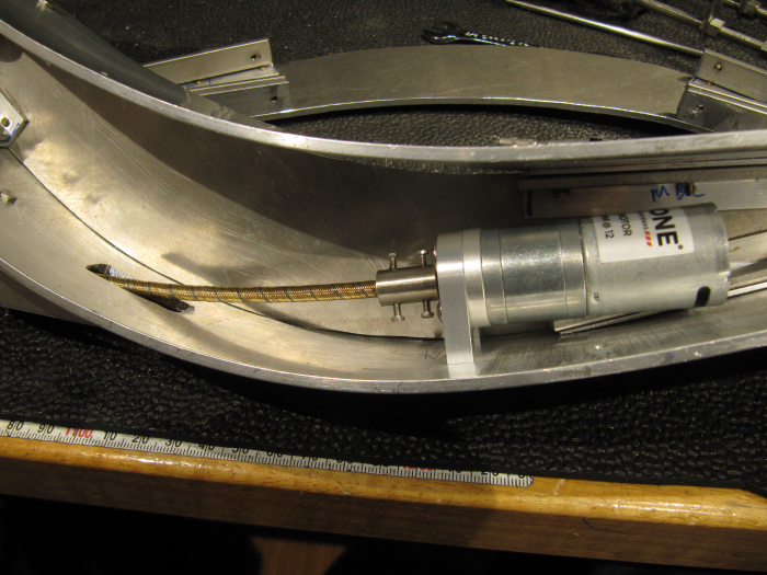

Back on the excavator today - I already had some Octura flex cable that I considered for use to connect the gearmotors to the cylinders, but it was too thin and twisted up under load. So, got hold of some of the thicker version, at .187" diameter, That is able to take a much higher force without twisting in either direction, and is still flexible enough for the gentle bends that I need to get out of it. This stuff is very handy, can transmit power without the noise of universal joints. I made up a set of ends for it, enough for all four cylinders, that have setscrews for the cable and the cylinder/motor shafts. Here is one set in place with one motor and cylinder:
Here is about where it will sit, inside the boom and extending out to the bottom end of the cylinder:
Next I will get the motor mount holes drilled, and also need to make up the final shaft stubs for the clevises on the cylinder ends (been using some temp bits that happened to fit out of the scrab bin). Then I can wire it up to the speed control/radio and give it a real test. If all goes well, will get the other cylinders/motors installed.

And another bit done this evening - made the pivots for the cylinder ends, and milled the opening for the first flex shaft (to move the stick). The motor has been mounted, ready for some wiring to test it all. Here is a view inside the boom:
and where the flex shaft comes out and connects to the cylinder end, to drive the leadscrew:
So, still need to wire up a ESC to the motor and hook up to a channel on the radio, and it will be ready for a trial run to see what kind of force it can put on the booms, and see how the travel time is. I've got some faster and slower gearmotors that I can switch to if needed to dial in the max speed and force on the cylinder. Hopefully it works well enough to continue on without having to change the leadscrew out.

Just one question, how are you going to lubricate the lead screws?
Kerst
  #36
Old 02-25-2020, 08:04 AM
crueby crueby is offline
Join Date: Mar 2019
crueby is on a distinguished road
Default Re: Cat 340D Excavator build
Originally Posted by kerst View Post
Very nice!
Kerst
Hi Kerst,
The leadscrew bases are held in with sealed ball bearing units, so that end is good. The screws themselves are polished steel with bronze followers, so they are designed to be able to run dry in the robotics world, but given the loads on the model I figured I would give them a thin coat of CopGraf for good measure. By pulling the crosspin on the tips of the cylinders, the piston can be unscrewed from the leadscrew and removed for access.
