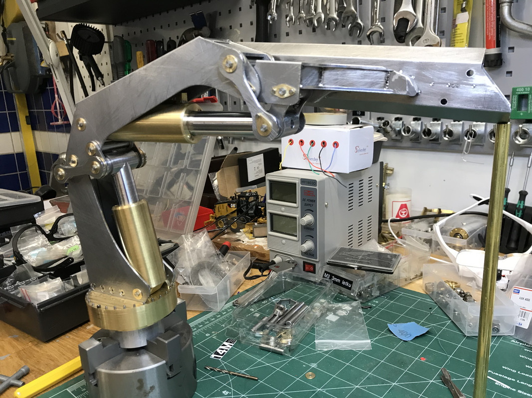

Some progress with the crane

As usual, a most astounding display of craftsmanship! Your welding machine certainly makes putting the pieces together easier and neat. Awesome!
