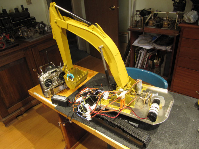

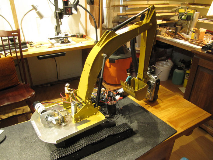

Got enough wired up to do some testing - the bucket and stick motors working well, the motor that drives the two cylinders on the main boom does need an upgrade though - with the weight of the booms and bucket extended out, it is really struggling. So, I need to either add some more gear reduction or swap out to a different motor with some more oomph. Still need to wire up the cab rotation motor and test that one...

Got enough of the wiring done to test things out, and swapped the main boom motor for a slower/stronger one which is pretty close but could be a little faster. Here is a short video testing the different functions out, moving slow so I didn't whack anything on the table and so I could learn which stick did what!
https://youtu.be/xkGL3TcqJPY

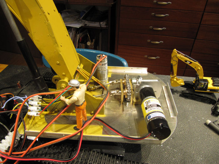

Got the bigger/stronger gearmotor installed for the main boom raise/lowering, had to rearrange a few things to get it to fit in the cab. It works much better, the original one was barely able to raise the boom assembly. This one could be just a little faster, may swap up to the next rpm range on it (they come in a series of gear ratios). This one is quite a bit longer, so it has to sit sideways in the cab, and have a bevel gear set to attach it.
The shop elves are measuring things up to make a rack to hold all the speed controls, they are just temp wired in using some terminal blocks to test things out, want to have them all in a row and the wires neatened up from the current rats nest.
