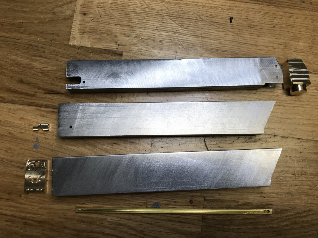

I also got back working with the support legs. I was first thinking that I use two separate cylinders for the two sections,
but now I'm considering one cylinder with steel wires and pulleys. Both options are hard to make due the lack of room inside the square tubing.

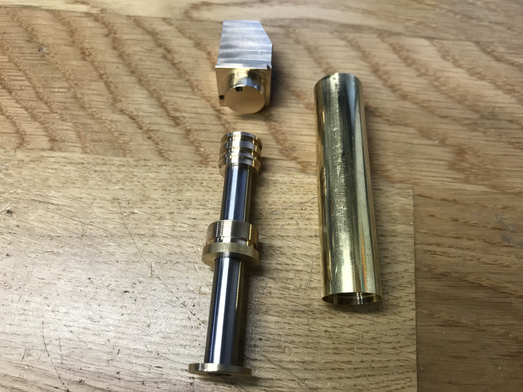

Here's what I have got done with the support legs. The first picture shows the insides of the mechanism. The push and pull wires and the hydraulic tubing are not shown.

I soldered the support leg cylinders together today
