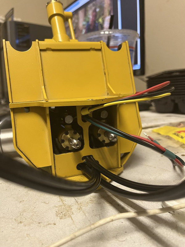

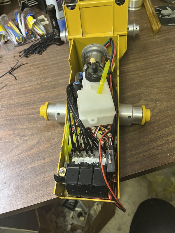

That front half took all day to wrestle that stiff hose in place & not kink any, then lock the axle down in place. Sure hope I don’t have any leaks.
Starting to look like something now.
I installed the rear axle yrs ago & realized today I must’ve used bolts a bit too long on the pivot parts that attach to axle, both wheels are locked up.

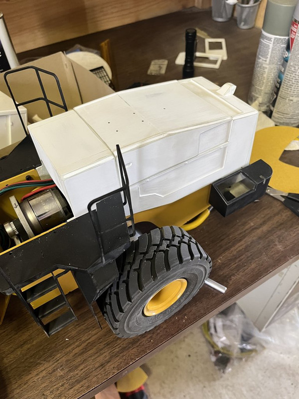

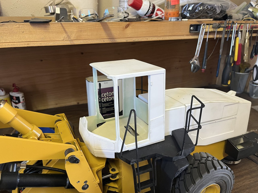

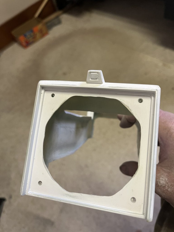

Made good progress on the WA500 last week, got the bottom half pretty much finished, everything working, haven’t put oil in it just yet. Now working on the top half.. cutting, filing, sanding, fitting; hope to start painting midweek.

That upper section looks like it fits like a glove....really nice work...

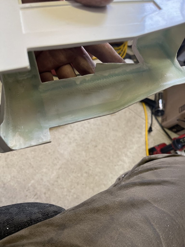

Indeed Jerry, Frank Preisendorfer of Fumotec is a world class master modeller with the kits he produces, I think he’s closing in on 30yrs in the biz and every kit he puts out, all the pieces fit together precisely to not only look 1:scale but also be robust & durable for 1000s of hrs of trouble free enjoyment. Also, his customer service is AAA+
Todays work has been hrs of sanding with 220 grit to smooth out mold lines & rough up the Glass Fiber Resin surface so the paint sticks well.

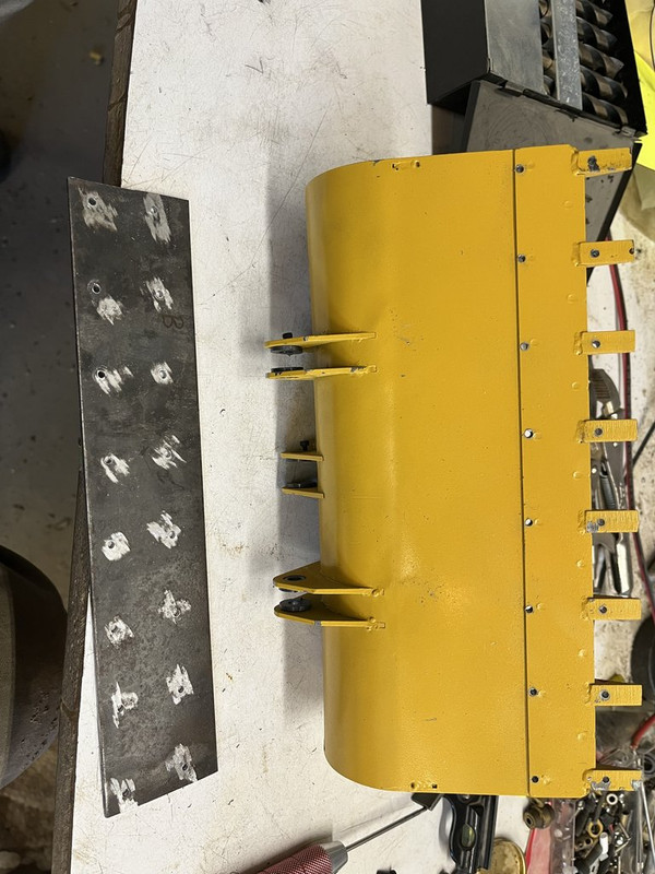

Made a bolt-on straight cutting edge for the bucket.

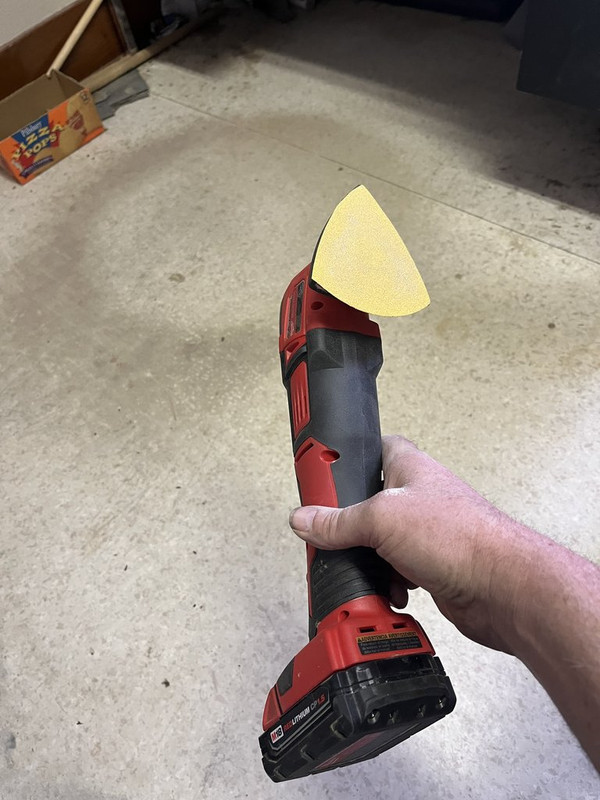

Luv my Milwaukee cordless tools.. this one worked great with 80 grit to shine the surface rust off the steel detail parts & smooth out the flash edges from laser cutting.
Metal etch primer coat
The metal detail parts fit into the indents in the body, a very clever way to add detail to this 13 yr old kit.

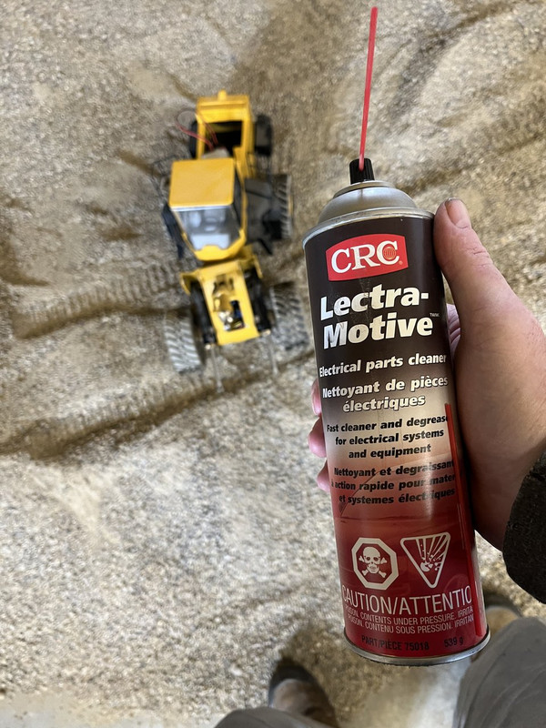

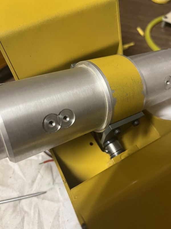

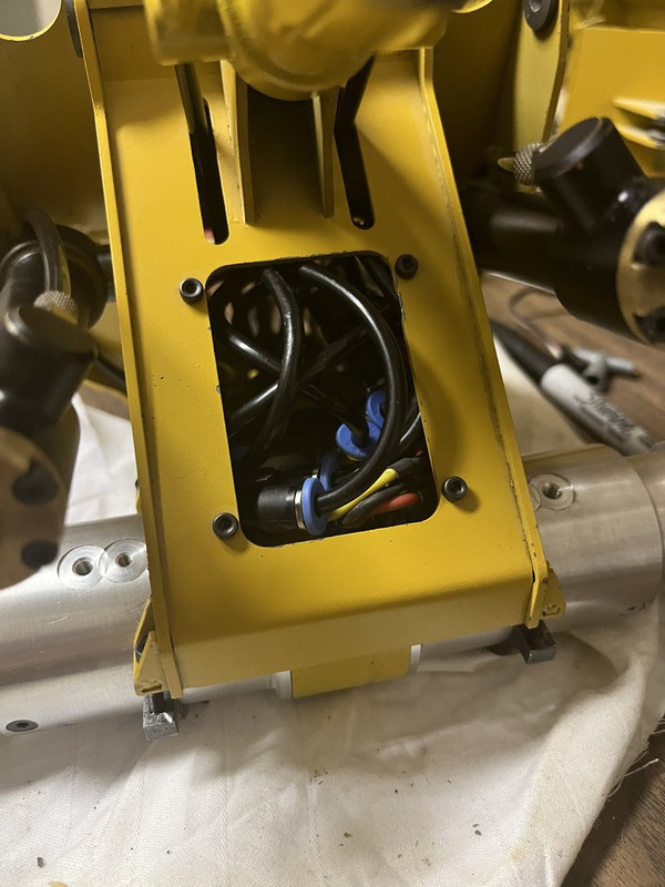

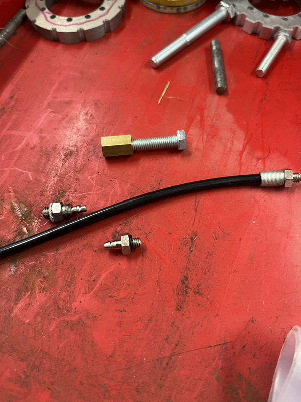

The darnedest things happen to me, not just with these models either .. look at the top left thru the hole, bottom of lift arm cyl’s knurled compression collar rubs on hose of steering cyl every time bucket touches ground & collar loosens itself till the hose pops off under pressure.
Shortened some hoses, rearranged others, trying to get steering hoses away from swinging arc lift cyl fittings.
Had some barbed fittings with push on collars that could’ve been the cure but were 4mm thread instead of 5.
Oily mess! This electrical cleaner does wonders to wash the oil away & doesn’t affect paint.
