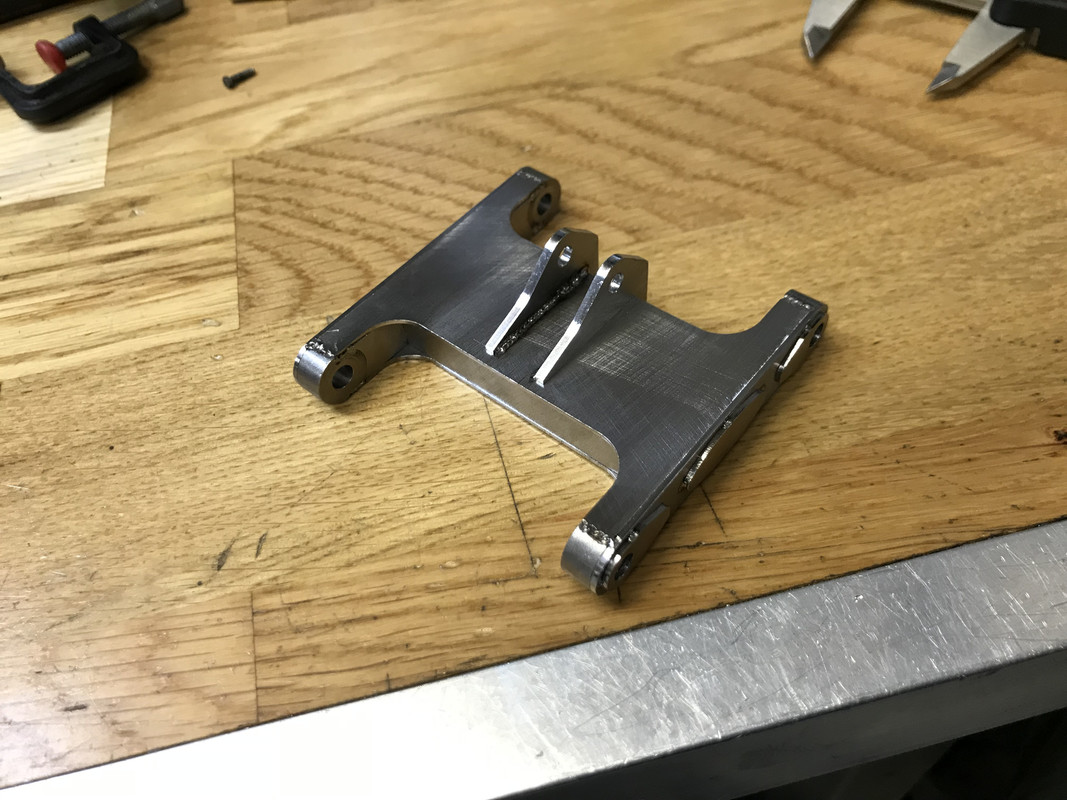

More parts for the ripper

Old 11-14-2021, 12:38 PM

Are you using sheet metal option in Fusion 360 to design these parts?
Yes I am.

This project is nuts, it just keeps getting more awesome!
Plus that's some pretty sweet looking low profile Tig work.

I got the ripper teeth holders done and welded. I also started to make the teeth bodies, the tooth tip is a separate piece.

Beautiful work as always. Are you using a filler wire on your welds or just doing a series of spot welds?
Those are all spot welds.
