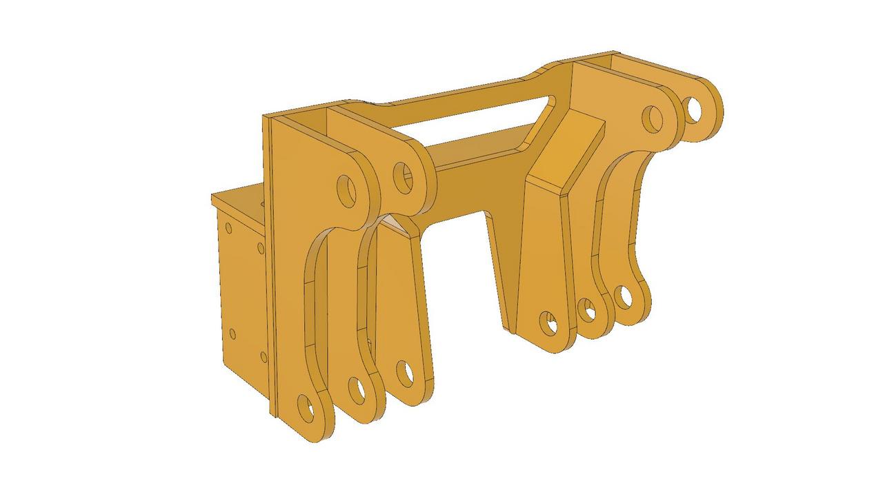

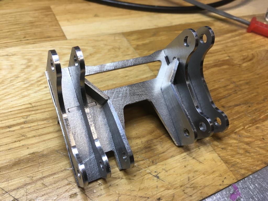

I got some machining done also. This is the rear sub frame for the ripper

Welded together and in place

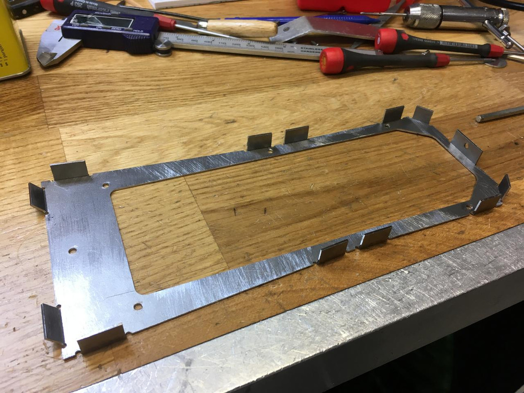

I got the cab base plate and the under plate done
