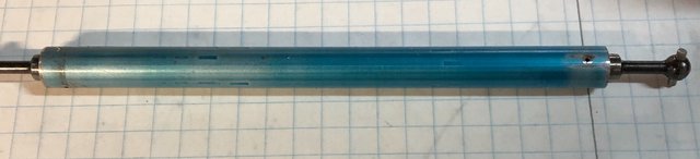

Would love to see more info on how you built the drive shaft. I did a very simple extension with copper brake line and brass tube and it's still held together with masking tape.

For the drive shaft, I cut the stock Tamiya dog bone in half. It's soft enough to easily cut with a hack saw and drill. The new shaft is 3/8" dia. solid aluminum with a 15/64" hole drilled on each end. One half of the dog bone fit perfectly; no slop, but loose enough to adjust in/out easily. The other half was too tight, so I chucked the 15/64 bit backwards in my drill, put some rubbing compound on the smooth end of the drill and ran it back and forth in the hole until I got the fit I was looking for.
With the dog bones adjusted to the right length, I cross-drilled with a 5/64" bit and drove in a split pin. Using a pre-drilled 3/8 bushing in the vise helped keep the bit centered.
I thought about putting a flat spot on the dog bone and using a set screw, but this just seemed easier. We'll see how it holds up.

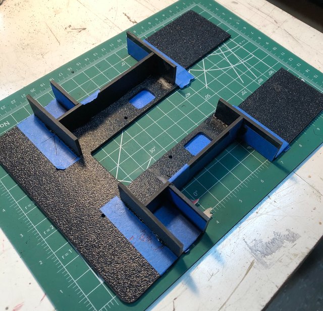

Finally making a little bit of progress. The cab will be lowered, shifted forward and lengthened almost 3”, so I needed a new floor. After a lot of trial and error, I ended up using 1/8” ABS.
I’ll need four more seats, so I may try casting them using fast cast resin.
A coat of white paint for the pink shocks.
Finished up the hinges for the tilt cab.
I’ll eventually attach the cab to the floor with a few screws, so the entire assembly will tilt.

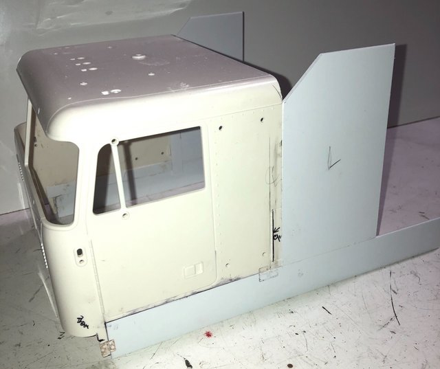

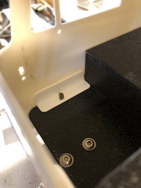

Added some 3/8" styrene angle to the cab so that I could attach it to the floor with screws.
Mocking up the rear body with 1/8" hardboard and hot glue just so I can figure out where to put things before I start cutting plastic.
