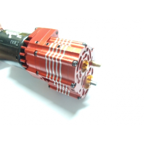

since the HL tranny was huge and not geared down, I found this on evil bay and dropped it in. yeah bit expensive but a planetary to a two speed trans to a transfer case all in one.
I made the plunge and drilled holes and tapped it in! (ALSO!! It has an RC4WD 80T motor!)
and now I have a 6x6 Globe!! (I have yet to get the drive shafts though!!)

Looks like a really nice truck and trailer combo! I wanted one those planetary transmissions too, but when I started getting serious about buying one, Rigid RC was all out of them. Oh well. Let me know how you like that transmission.

I got mine from amusingparts123. it was on the uk ebay. think i paid a bit too much for it but at the time it was the only source i knew of. there is a link on the parts bag that came with it that i got the manual off of and they list it a bit cheaper on their website. http://www.wtbcar.com/ Some interesting things on there but some is expensive..

This is how the new transmission sits

it is nice and compact. Will have to wait to see how fast it is when the drive shafts show up. if its too fast i can still fit in another planetary!! lots of room under the floors still!

Cool build and that tranny looks great sitting in there, I've been eyeing them up too. looks like the same one as in rc4wd Armagedon 8x8

this one here?
that is the "high torque" version. I cannot confirm if it is still 4wd. Seems like a waste if that is what they put in that truck because it goes to a transfer case half way down.
http://www.wtbcar.com/shopping/image...hv-500x500.jpg

No telling if that new transmission is AWD capable, from those pictures anyway. A divorced transfer case might seem like a waste of money, if the new transmission has two output shafts, but from a packaging standpoint, that might be the best way to set things up. There probably isn't enough room in the center of the chassis for a motor and transmission.

Here's a better pic showing that it is indeed Awd, I must have meant the 8x4 Armaggedon

i think the high torque version is just an additional planetary before the transmission's built in planetary. I already told myself it is too fast ill put another one in lol
