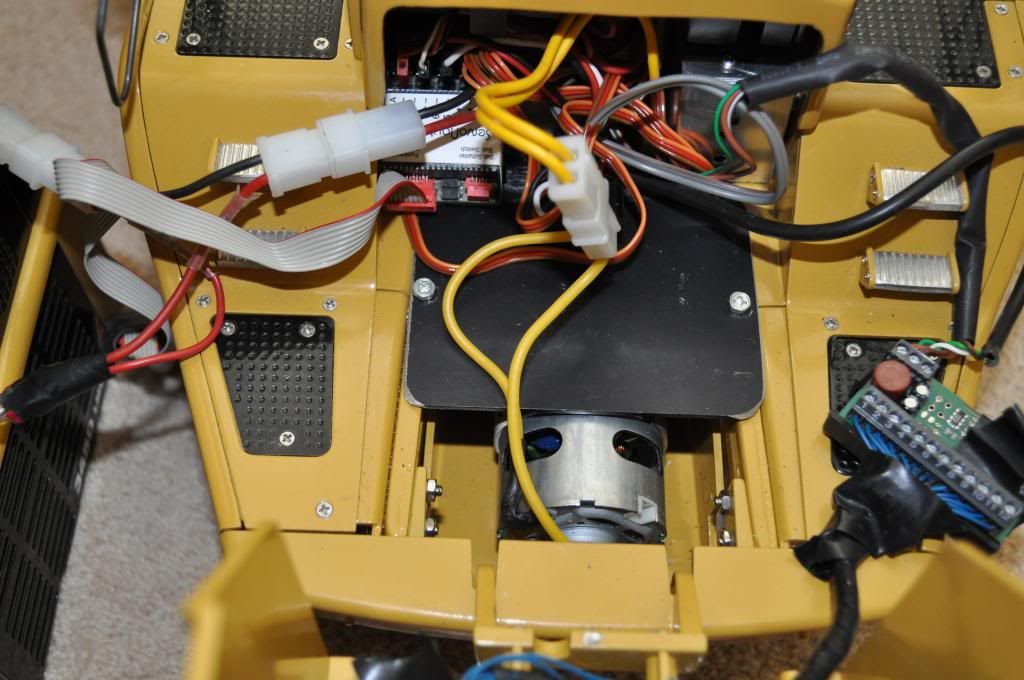

hello hav u got any pics of the way u mounted the motor
cheers justin

Default Re: New Transmission required Wedico 740 Dumper

I was thinking of putting a 14v lipo in it but not sure if the Wedico electronics can handle the extra voltage. But yes the flat ground speed is good.
