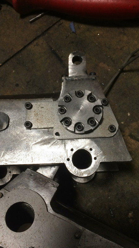

Little bit of progress since last time :
Making a blade and hydraulic ram pivots:
I also had a nice delivery from Premacon so I thought it would be best to put together a pump set that I could test outside the machine for leaks etc then simply bolt in position and connect the rams
https://youtu.be/hY6JiJXL7Pw
The weight of the blade is quite a lot and I am concerned that the rams wont lift it !
