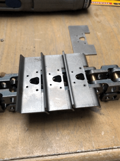

So a little progress has happened since last time...
One side of the track links are complete ( awaiting metal to machine pads). these take so long !

Those track links are looking great! Where did you get the laser cutting done?

I found a relatively local engineering shop that supplies all sorts of metal and cutting services. I have found that although laser cutting is fairly accurate, it still leaves me with a lot of work to bring the items to an acceptable finish. Laser cutting also leave poor edges and seems like it also hardens it?
Its still a lot better that cutting 10 mm plate steel with a hacksaw so I wont complain !
The round stock and flats I get from another supplier. I just send the diameters I need and lengths. I can use my lathe and mill to do the rest.

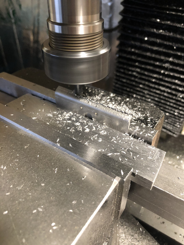

So had a little machine time the last few weekends:
track profiles turned up so experimented with forming the right bends etc
it needed a little trimming
End result
the gap between the pads was a little too big so had to readjust the jig
these are the ones I will be going with
they need slightly milling at the front so there is a couple mm tolerance but generally they operate well. still need practice on tig as my welds are shocking: )
